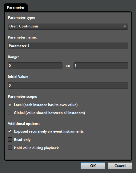

Studio 2.00 greatly expands the potential of parameters, simplifies their management, and improves their flexibility.

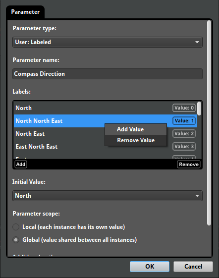

Labeled parameters can be used to discretely align parameter content and automations to a set of labeled values.
Labeled parameters can be defined when creating or editing a parameter. Insertion, reordering, and removal of labels is gracefully handled when when editing labeled parameters.
Discrete parameters use whole numbers instead of decimal values. As with labeled parameters, discrete parameters can be used to discretely align parameter content and automations.
Global parameters share the same playback position between all event instances. This makes it easy for the game code to set a single parameter value that affects many event instances.

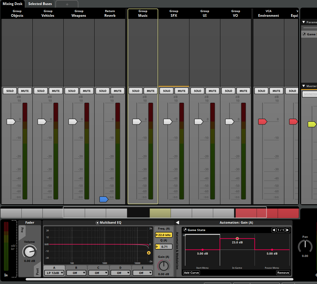

Global parameters also allow for automation of properties in the global mixer.
The new speed built-in parameter is automatically set to the speed of the event instance it's used in (determined by the velocity of the event instance relative to that of the listener). This can be used to automate properties of an event instance based on how fast it is moving.
Many changes have been made to expand how flexibly parameters can be used. For example, it is now possible to automate one parameter by the value of another parameter. This can be used to remap the value of a parameter.

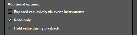

Additionally, parameters can now be marked as read-only. This is useful for indicating that a parameter doesn't need to be set in code. For example, this can be used when a parameter should only be driven by modulation.
Finally, support has been added for editing a parameter's type after it is created. This includes gracefully handling changing a continuous parameter to a labeled parameter and vice versa.

It is now possible to directly add modulation to properties in the global mixer. This makes it easy to apply sidechain or LFO modulation directly in the global mix.

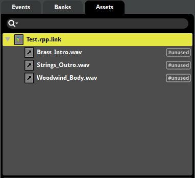

The newly added Reaper integration streamlines the process of importing and updating assets when working with Reaper.
The Reaper integration allows for the linking of a Reaper project as a linked project asset. Linked audio assets can be updated and refreshed automatically if changes in the source Reaper project file are detected.
It is also possible to directly import the timeline of a Reaper project as an event. This will create instruments and markers that align to the source Reaper project content.

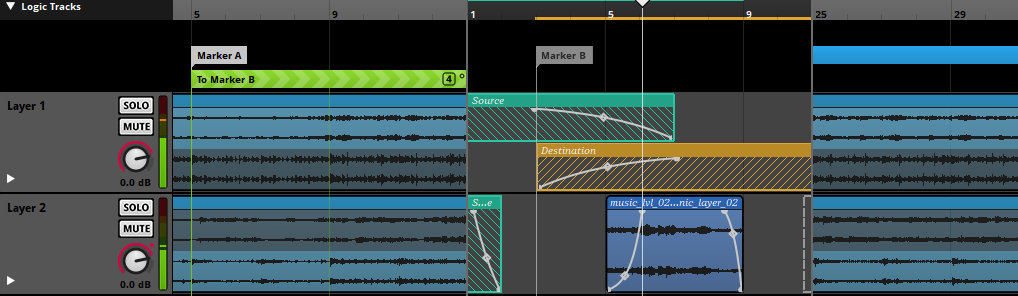

It is now possible to overlap the source and destination regions of transition timelines. This makes it possible to crossfade between the source and destination of timeline transitions, on a per-track basis.
This feature was added late in Studio 1.10 but is worth highlighting here.
