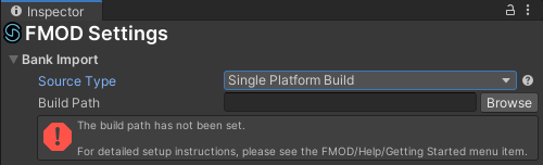

  1. Select "FMOD > Edit Settings" from the menu bar; this will show the FMOD for Unity settings in the Inspector:
    FMOD for Unity Settings
  2. Select your desired Source Type:
  3. Set your speaker mode.
  4. Configure plugins if you are using them.
  5. You can now access your FMOD Studio content. From here, you can:

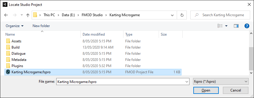

In the FMOD for Unity settings, set Source Type to FMOD Studio Project:
Project path
Then click the Browse button and locate the .fspro file:
Locate Project
Using a Single Platform Build
With this access method, you specify a directory containing a single set of .bank files built from the FMOD Studio project. This is suitable if you are developing a game for a single type of platform (such as mobile only), as you will only need one set of .bank files. You can store your .bank files in your Unity project if you wish.
All developers on the game will need access to the .bank files.
In the FMOD for Unity settings, set Source Type to Single Platform Build:

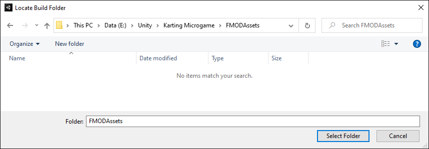

Then click the Browse button and locate the directory that contains your .bank files:
Locate Build Folder

Then click the Browse button and locate the top-level directory:
Locate Build Folder

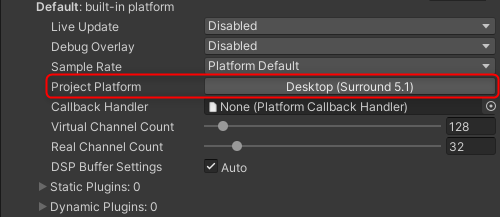

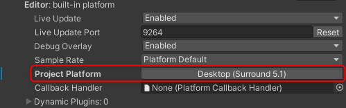

You will then be able to set the Project Platform (consisting of subdirectory and speaker mode) that you want each platform to use:
Platforms

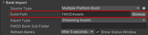

You can store your FMOD Studio source files (your project or .bank files) in a directory at the top level of your Unity project. This allows you to provide access to them through the same mechanism you use for your Unity project. You can also set a relative path in the FMOD for Unity settings, so that even if you move your Unity project the source files can still be found.
To do this, create a new directory at the top level of your Unity project (for example FMODAssets) and put your source files inside it:
FMOD Assets in Unity Project
  • Do not put an FMOD Studio Project inside the Assets directory, as Unity will try to import it into the project.
  • Banks can be stored inside the Assets directory, as assets that are not referenced or used in any scene will not be included in the built game.
Then click the Browse button and locate your source files. This will set a relative path in the FMOD for Unity settings:
Relative Build Path

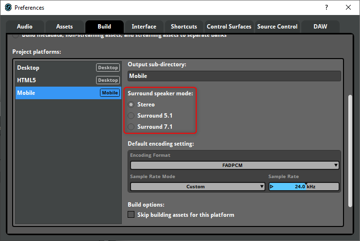

Setting Your Speaker Mode
For each platform, set the "Surround speaker mode" component of the Project Platform setting to match your FMOD Studio project:
Speaker Mode
Studio Speaker Mode

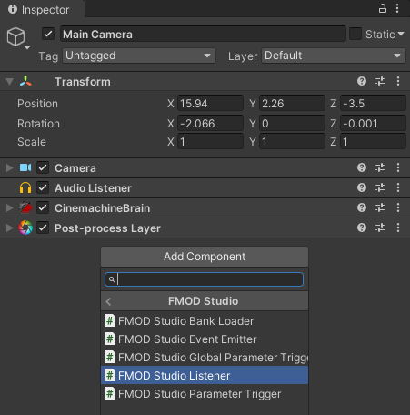

2.2.1 Adding the Listener
Add the FMOD Studio Listener component to the main camera Game Object in your scene. This will provide the FMOD Engine with the information it needs to play 3D events correctly.
Attach listener

2.2.3 Adding FMOD Components to Game Objects
You can add FMOD components to Game Objects using the Add Component button in the Inspector. For each component, you can choose which trigger conditions will trigger its actions. The available components are:

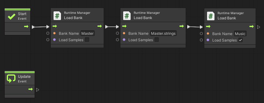

2.2.6 Integrating with Visual Scripting
Visual scripting units are provided for accessing the FMOD Studio, FMOD Core and FMOD Unity APIs. Please see the Visual Scripting section for instructions on setup and usage.

  1. In the Platform Specific section of the FMOD for Unity settings, select the Editor platform and set Live Update to Enabled. You can set the network port used for the connection in the Live Update Port field.
    Live update settings

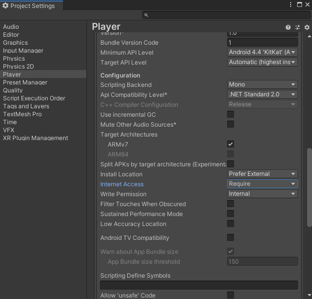

    • Android:
      1. To get networking running on Android in Unity you need to go into Build Settings -> Player -> Other Settings.
      2. Then find the Internet Access setting and change to Require based on this image:
        Connection dialog

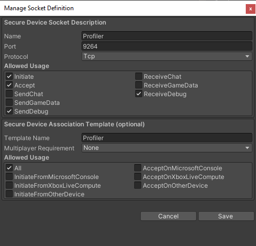

    • Xbox One:
      1. To get networking running on Xbox One in Unity you need to setup the required sockets in Build Settings -> Player -> Publishing Settings -> Configured Sockets.
      2. Select Add, then fill out the settings based on this image:
        Connection dialog

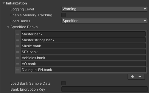

To control which .bank files are loaded, set the Load Banks option in the FMOD for Unity settings to either None or Specified. If you set it to Specified, make sure that no more than one localized .bank file is added to the Specified Banks list.
bank Loading
To change the locale, unload the current localized .bank file, and then load the new localized .bank file. You can do this using the FMOD Studio Bank Loader component, or by calling RuntimeManager.LoadBank and RuntimeManager.UnloadBank from your own script.

By default FMOD for Unity will load all .bank files when it is initialized. For more control over .bank file loading, set the Load Banks option in the FMOD for Unity settings to either None or Specified. You can then use the FMOD Studio Bank Loader component or the RuntimeManager.LoadBank and RuntimeManager.UnloadBank methods to load and unload .bank files as needed.
Bank Loading

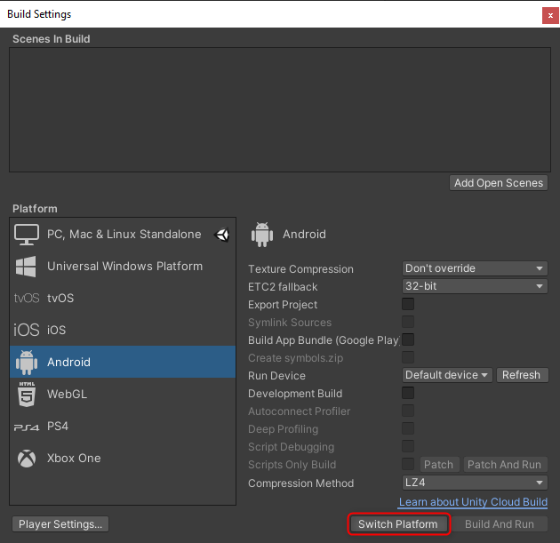

In Unity, you can set the current platform from the build settings. Select "File > Build Settings..." from the menu bar, then select the desired platform and click the Switch Platform button:
Build switch platform

Loading banks
Loading banks
This visual script loads three banks in order - first the Master bank, then the Master strings.bank, then finally the Music bank with all of its samples preloaded.
