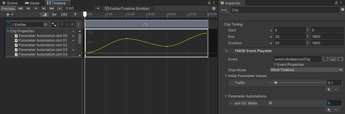

5.2.4 Parameter Automations
A list of parameters with associated automatable values. You can control parameters in this list over time by creating curves on the timeline. These parameter values will be set on the event every frame while it is playing.
Each automated parameter is assigned to a slot. You can edit the automation curve by selecting the relevant slot in the timeline track's curves view, or by right-clicking the parameter in this list and using the context menu commands:
