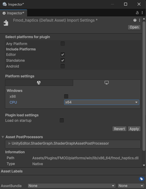

The FMOD Haptics dynamic library is disabled by default, but needs to be enabled on your relevant platform for it to be packaged into the build. Here is an example of how to enable the fmod_haptics library on Windows and Quest.

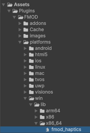

Windows
  1. Navigate to Assets\Plugins\FMOD\platforms\win\lib\x86_64
  2. Select the fmod_haptics plugin
    libfmod_haptics library location
  3. Set the CPU to x64
    FMOD Haptics Enable Plugin

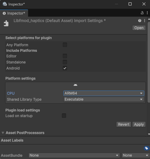

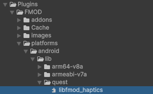

Quest
  1. Navigate to Assets\Plugins\FMOD\platforms\android\lib\quest
  2. Select the libfmod_haptics plugin
  3. Set the CPU to ARM64

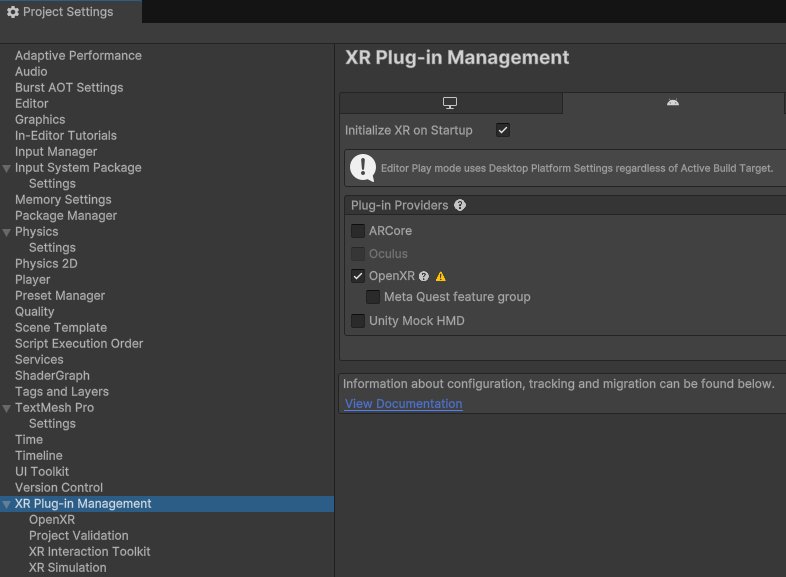

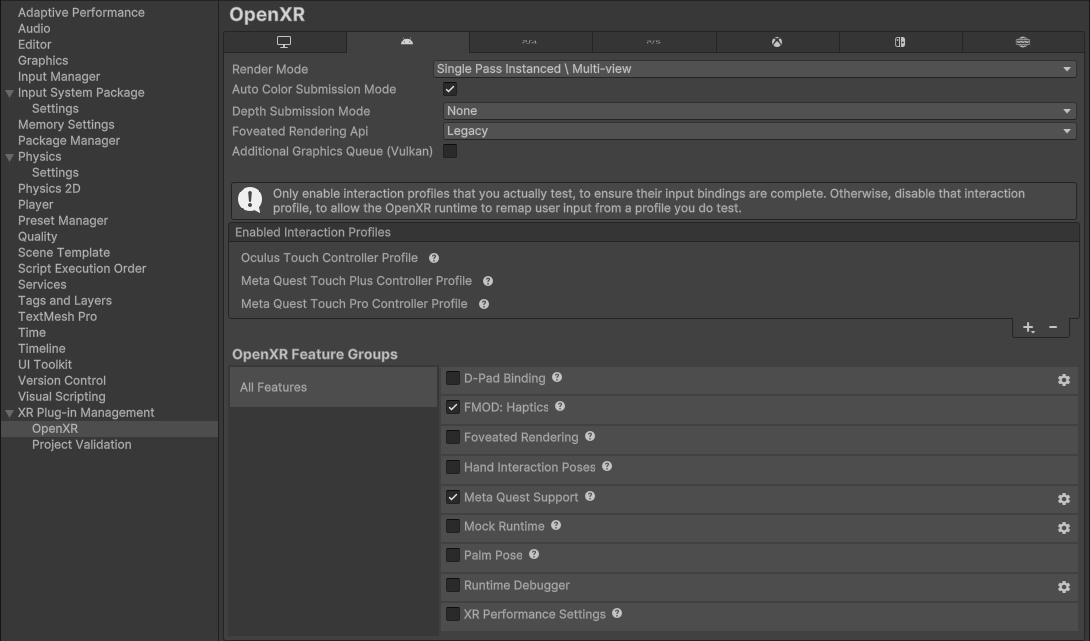

The OpenXR Plug-in must enable the "FMOD: Haptics" feature for haptic playback on Meta Quest. The following settings are only accessible when the Android platform is active.
  1. In the Unity menu, select "Edit > Project Settings > XR Plug-in Management"
  2. Select OpenXR as the Plug-in provider
    XR Plugin Management

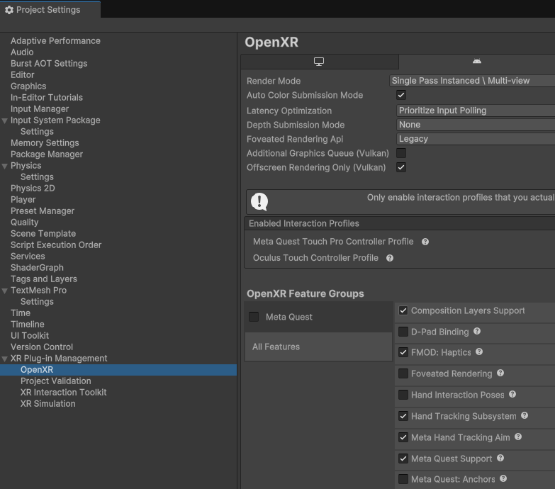

  3. In the left pane, expand "XR Plug-in Management" and select "OpenXR"
  4. Check the "FMOD: Haptics" feature group
    OpenXR Feature Groups
  5. Ensure you have any relevant interaction profiles enabled for the devices you are targeting
    OpenXR Interaction Profiles
You should now be able to trigger vibrations on Meta Quest controllers by playing any event containing a haptics instrument.
